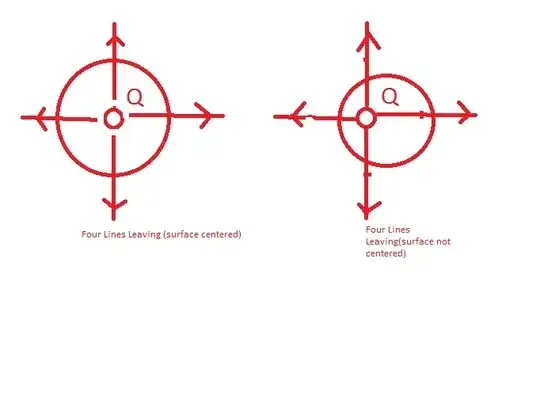

I was trying to understand Question 2 also but I think I got it now. If you literary think of Electric Fields as "lines" then the total number of "lines" leaving the surface is always the same as long as the surface enclose the charge. Even if the charge is not at the center!! In my picture below, I present a simple scenarioenter image description here where instead of infinite electric field lines, lets say a charge Q can only give off 4 electric field lines... Observe that 4 lines will leave the sphere regardless of whether or not it is center... the "Total" electric field lines leaving is 4.
