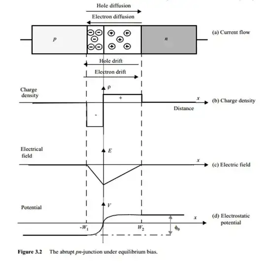

The reason I ask this though is that from my understanding of the depletion region and built in potential of a diode it seems like if you connected a voltmeter across the whole diode it would show the value of the built in potential.
This is explained in the image below:
pn junction under equilibrium bias
At first, electrons flow from the n type to the p type because there are a higher concentration in the n type, and holes do vise versa. This is called the diffusion current. The first electrons and holes to cross the pn boundary are the ones which are closest to it; these carriers recombine when they meet each other and are then no longer a carrier. This means there is a depletion region of no carriers near the pn boundary. because electrons have left the n type material, and holes have left the p type material, there is a surplus of positive and negative charge on the n and p side of the pn boundary respectively. This causes an electric field that opposes the diffusion current, and so no more electrons or holes cross the boundary and combine. In short, only the electrons and holes near the boundary combine, because after they have done that an electric field is formed that prevents any more carriers from crossing. The current due to this electric field is called drift current, and when in equilibrium this will equal the diffusion current. Because there is an electric field at the boundary (pointing from the positive charge to the negative charge) there is an associated voltage. This is called the built in potential.
If you sample the electric field at each point along the diode from left to right, you would start with 0 in the p region because there are an equal number of protons and electrons. As you approach the depletion region you would see a small electric field pointing back towards the p region, caused by acceptor impurities which now have an extra electron (due to recombination) and therefore now have a net negative charge. This electric field would increase in strength as you get closer to the boundary, and then die away as you get further away.
This electric field means there is a voltage, as shown in graph (d). The p side is at an arbitrary potential, and the n side is at a potential higher than this because there is an electric field between them. This means there is a potential difference across the depletion region; this is known as the built-in potential.
But why when I connect a volt-meter across the whole diode will I not see this built in potential?
Because at equilibrium (V=0) the Fermi-level throughout the whole device is flat. A voltage will only exist when there is a gradient in Fermi-level over the component (i.e. a voltage drop).

In a simple idealized view, the Fermi level is the top energy level in the solid occupied by electrons. In silicon with no doping it sits at mid-gap: the valance band is full, the conduction band empty. In a thought experiment, if you had two separate chunks of intrinsic silicon each would be perfectly happy in isolation. If you could mash them together to make a "junction", everything would still be perfectly happy - the Fermi levels line up, and no electron has any real desire to do something else.
Adding dopants shifts the Fermi level. In n-doped material there are newly available occupied levels near the conduction band edge, and in p-doped materials there are newly available un-occupied levels near the valance band. By doping the material you have fixed the Fermi level at a new point. In isolation, the n-doped chunk is happy, and the p-doped chunk is happy. Here, though, when you mash them together to make the junction, they realize that together they aren't happy. The occupied levels on the n-doped side are above empty levels in the p-doped side: this is a non-equilibrium condition since electron (hole) flow will reduce the energy of the system. But wait! Indeed, the electrons (holes) start sloshing around, but in doing so they leave behind the dopants. These now-abandoned dopants have a net charge, and an internal field begins to build up. It will build up until it is large enough to prevent further electron (hole) flow across the junction. However, an equivalent view is that this built in voltage is just what is needed to bring the different Fermi levels into alignment (as in @boyfarrell's picture above). (I find the water analogy a bit misleading, since it is the separation of fixed dopants and moving charges that leads to the build-in voltage.)
So, ultimately, yes: the built-in voltage is precisely what makes the p-n junction in equilibrium with no net potential across the terminals.
