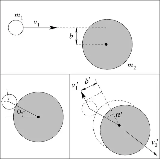

Here is a general figure of an hard spheres collision drawn in the center of mass of the mass $m_2$ before the collision. The black dot is attached to this frame.
Steps of collision between two hard spheres in two dimensions
To solve the problem, you need to observe
  • Conservation of energy: $m_1v_1^2=m_1(v'_1)^2+m_2(v'_2)^2$.
  • Conservation of momentum: $m_1\vec v_1=m_1\vec v'_1+m_2\vec v'_2$
  • Conservation of torque with respect to the center of mass of $m_2$: $m_1v_1b=m_1v'_1b'$.
I have drawn a 2D problem, so you have four unknowns (two for $\vec v'_1$ and two for $\vec v'_2$). And there are four equations (one for energy and torque, two for momentum). So the problem is solved.
In three dimensions, you have $6$ unkowns, energy conservation provides one equation, momentum conservation provides $3$ equations and torque conservation provides two.

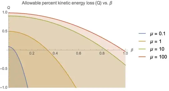

In short, the resolution is that (classical) hard sphere scattering cannot be elastic in general (though it can be in special cases). I'll explain in a moment why that is the case, but first, I'll give a solution that "works." Here, I introduce another dimensionless parameter $Q$, which is the ratio of energy loss over initial kinetic energy. The modified solution is:
$v_{xf} = \frac{\left(\beta ^2-1\right) \sqrt{\frac{v_1^2 \left(\beta ^2 (\mu +2)^2+\mu (\mu (Q-1)+Q)\right)}{\beta ^2-1}}-v_i \left(\beta ^2 (\mu +2)-1\right)}{\mu +1}$
We can now plot $Q$ vs. $\beta$ for varying values of $\mu$: Plot showing kinetic energy loss/gain as a function of $\beta$ for various values of $\mu$.
It's important to note that this only provides a bound on $Q$. It does not tell us what value of $Q$ we should use. In other words, the problem is no longer fully constrained. So, what's going on here and how can we resolve it?
Here's the bottom line: hard sphere scattering is not physical! To have a true hard sphere (i.e. impenetrable) we would require the force at the surface of the spheres to be infinite, i.e. the force law would be a Dirac delta function. The impulse experienced, then, would be: $\Delta p = F \Delta t = (\infty)(0)$. This is undefined. It’s not surprising, then that we might get some strange physics out of hard sphere scattering. Moreover, it’s not surprising the problem would be unconstrained.
