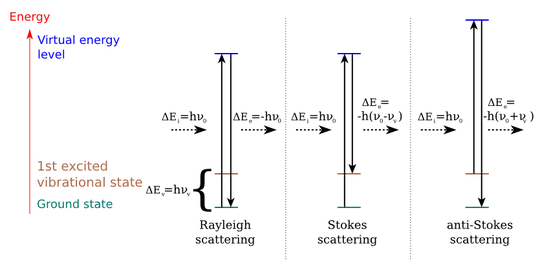

Below is an image which shows 3 different situations. The Rayleigh scattering does not change the energy of the light because the decay is back into the original state. Raman scattering though will decay into a different state (the different energy levels due vibrational modes of the molecules) with the difference in the energy resulting in a change in color/frequency of the scattered light.
Raman

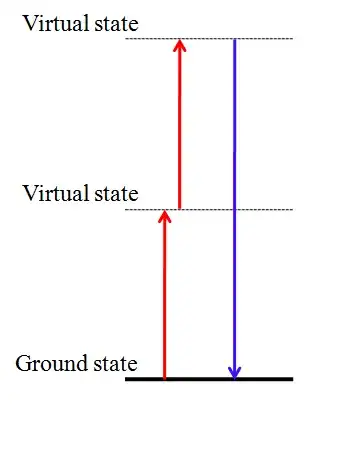

In second harmonic generation a photon is absorbed and before the material decays into a real energy level, a second photon is absorbed. When the material re-radiates the energy it only emits a single photon, so effectively 2 photons were combined to create a single photon with twice the energy/frequency, and the final state of the material is in the same level it was to begin with (unlike the Raman scattering cases).
Second Harmonic

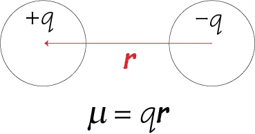

Picture of a molecule
Think of a molecule as a pair of charges $q$ and $-q$ attached by a spring (covalent bonds), like so:
When you apply an $\mathbf{E}$-field, the charges will attempt to separate. The dipole moment becomes $$\mu(\mathbf{E})=qr(\mathbf{E})$$ where $r(\mathbf{E})$ is the distance separation as a function of applied field $\mathbf{E}$. For simplicity, let's assume $r(\mathbf{0})=0$.
If the bond is harmonic, then Hooke's law is valid, and $\mu\propto\mathbf{E}$. Thus, the macroscopic polarization caused by millions of these "molecules" is going to be a field linear in $\mathbf{E}$. Remember that for later.
Otherwise, if the bond is not harmonic, then $d(\mathbf{E})$ is not linear in $\mathbf{E}$, so let's expand to second order: $$d(\mathbf{E})=a_1|\mathbf{E}|+a_2|\mathbf{E}|^2.$$ In this case, if you have millions of molecules reacting to a field $\mathbf{E}$, the polarization has a quadratic dependency on $\mathbf{E}$. Remember that for later.
