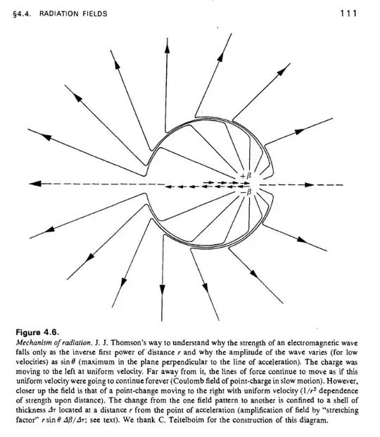

An electromagnetic wave propagates, not an electromagnetic field. An EM wave is a propagating disturbance in the existing electromagnetic field.
Consider the field of an isolated charged point particle - the field extends over all space.
Should the particle abruptly accelerate for some short time, the disturbance in the electromagnetic field of the particle will propagate 'to infinity' at the speed $c$.
From the classic textbook "Gravitation":
