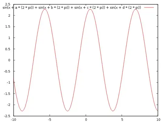

Using gnuplot with the following commands I plotted the sum of 4 Sine waves:
a = rand(0)
b = rand(0)
c = rand(0)
d = rand(0)
plot sin(x + a * (2 * pi)) + sin(x + b * (2 * pi)) + sin(x + c * (2 * pi)) + sin(x + d * (2 * pi))
And on the first go I got this:
add 4 sine waves together
Notice the shape and frequency is the same but the amplitude has increased. If you add them randomly together again you'd get something like:

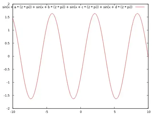

add 4 sine waves together again
Notice that the amplitude is still greater than 1 but the phase has shifted.
What's happening is that each Sine wave you add increases the maximum possible amplitude so the more you add the better the chance of getting a wave with amplitude greater than 1.
