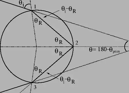

Actually this is a bit of a tricky problem that only was solved relatively recently. The primary rainbow is generated by a beam that refracts once inside the drop, reflects off the back, then refracts again upon exit.
angles

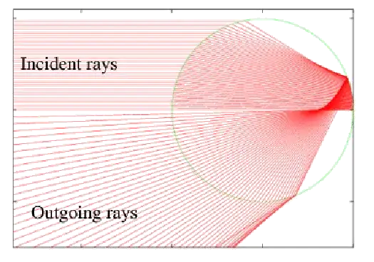

You have to use snell's law and then some calculus to find the minimum scattering angle for the angle that produces the brightest light as illustrated below from ray tracing:

For a fully worked example try here. And this site has some nice charts of the primary and secondary bows.
