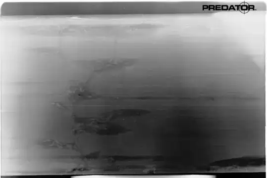

The easiest way to determine the uniformity of your slabs of wood is to take an x-ray. Seriously. This image is of an x-ray of a piece of wood where the dark regions are cavities created by termites eating away at it (the termites are the white things inside the cavities).
If you don't want to take an x-ray (or can't afford one), then just assume that since your wood is 1/8" square thick, it's fairly unlikely that the density is that far off from uniform. If you measure the center of mass and it's pretty darn close to dead center, I'd say it's probably good enough to be about 80-90% certain (depending on proximity to center) that it's uniform.
