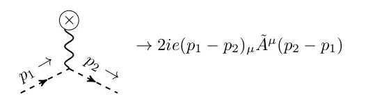

To calculate the Feynman rule associated with the first interaction you can calculate the two point function to first order in $e$ (depending on how comfortable you are with derivative couplings you may just be able to guess the answer),
\begin{equation} \left\langle 0 \right| T \phi _1 \phi _2 \int \,d^4y ( i e A _\mu \phi ^\ast \partial ^\mu \phi + h.c. ) \left| 0 \right\rangle \end{equation}
This leads the Feynman rule,
$\hspace{2cm}$enter image description here
where the $ \times $ denotes the effect of an external field. Note that the external field cannot appear as an intermediate particle since it was not quantized. The $ \tilde{A} _\mu $ is just the Fourier transform of the vector potential of the system. One can analogously calculate the Feynman rule for the second interaction.
