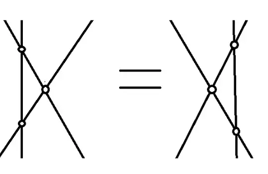

The Yang Baxter equation is formally, $$(R\otimes \mathbf{1})(\mathbf{1}\otimes R)(R\otimes \mathbf{1}) =(\mathbf{1}\otimes R)(R\otimes \mathbf{1})(\mathbf{1}\otimes R)$$ This is graphically represented as, Yang-Baxter
It basically says that three particle scattering can be reduced to a two body problem. So, no matter how large the system under study is we can always reduce the corresponding scattering matrices to two body problems.
