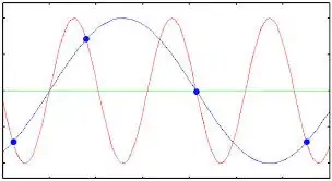

Using the Nyquist theorem, telephones will only transmit frequencies which are half the sampling rate called the Nyquist frequency correctly; so with a sampling rate of 8000 samples per second it will only transmit sounds with frequency less than 4000Hz correctly.
The fundamental frequency (the pitch you hear) of the human voice is in the range of 80 to 1100 Hz. Harmonic frequencies (component frequencies with an frequency of an integer multiple of the fundamental frequency) of the human voice may be much higher. Therefore a sampling rate of 8000 samples per second is sufficient to transmit human voices without many issues (harmonics may still exceed the Nyquist frequency).
When frequencies above the Nyquist frequency are transmitted, such as in the case of transmitting music, aliasing occurs. This causes distortion. This is detailed in the diagram below.
aliasing
The red line is the original signal. The blue dots represent times that samples are taken of the original signal. The blue line is the signal reconstructed by the ear from the insufficient sampling rate. As you can see, it has been distorted from the red signal and it now has a lower frequency; a frequency lower than the Nyquist frequency of the sampling rate.
