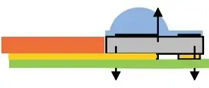

I have a mechanical design with LEDs that generate heat. I want to estimate the temperature at the LED junction vs. time, but especially at steady state.
Knowing the LED voltage drop and current, I can estimate the power dissipated via heat (some of the power goes to light, but to be conservative, I thought to estimate heat power as simply I*V).
The LED junction temperature needs to be held below a certain temperature. The thermal system will consist of the LED junction to thermal pad, the circuit board, and the mechanical design. The thermal resistance is given for the junction to thermal pad (about 10 K/W), and the manufacturer provides a couple different circuit board designs, each with their own thermal resistance. The best design can achieve 3-4 K/W, but a less expensive design may be an option. So I need the thermal resistance of the mechanical housing, which is pre-existing, and cannot be changed except for how to attach the LEDs to the housing.
The geometry is somewhat complicated, so I thought I'd start with a simple aluminum block (the circuit board mounts directly to the block), to make sure my modeling is correct, and then move to more complicated geometries. The LEDs are arranged in a line, so I'm going to assume the heat transfer is constant along the LED line (call it the z-axis). I also don't want to consider convection or radiation right now, along the length of the block.
So let's say I attach a heat sink to the end of the block opposite the LEDs, with a low enough thermal resistance to ambient so the heat sink end of the block is at ambient. The thermal resistance of an aluminum block is L/(kA), where L is the length, k is the thermal conductivity (0.25 W/(mm*K)), and A is the cross-sectional area. So if the length is 20 mm (along x-axis), the cross-sectional area is about 300 mm^2 (about 6 mm x 50 mm, with 6 mm along y-axis, and 50 mm along z-axis), the thermal resistance is about 0.27 K/W. The LED power per unit area is 0.0896 W/mm^2 (total power of 26.88 W, spread across the 300 mm^2).

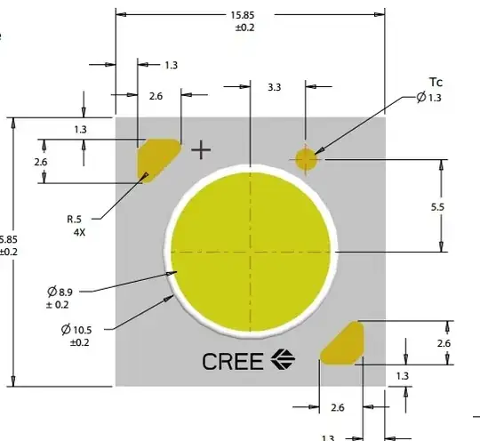

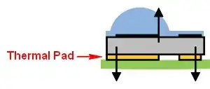

The manufactures now publish the temperature delta between T junction and T thermal pad, typically about 15°C. Some their recommend temperature values are relative to the LED's case temperature rather than T junction. For consistency, some manufacturers now include a Temperature "Spot" on the LED's case where you measure the temperature with a thermocouple.
The below image the Temperature Measurement spot is labeled Tc

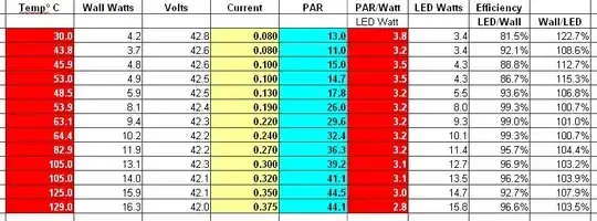

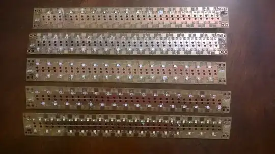

As I write this I am running an experiment with a new heatsink on a 12"x 0.7" PCB with 16 3 Watt LEDs (Cree XPE and Lumiled Rebel ES). The results of this modeling would be of little value.
You should concentrate your effort on the thermal management characteristics of the heatsink and PCB rather than the LED junction to thermal pad.

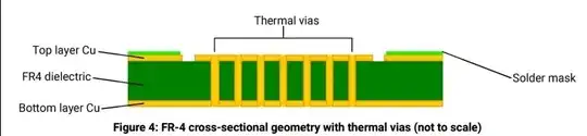

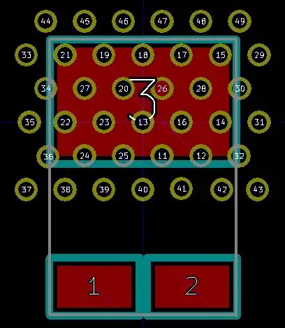

Another problem is the manufacturer's recommended circuit board designs. Still today, their recommendations consist of mostly how many holes, the diameter of the holes, and the distance between the holes to reduce the thermal resistance from the LED side of the board to the opposite side. That is because in their thermal model the PCB's thermal resistance is the greatest factor. A reduction in the PCB thermal resistance pays the greatest rewards. Except...
The problem with that approach is attaching the heatsink to the opposite side of the PCB. Why not increase the thickness of the copper on the LED side and attach the heatsink to the LED side of the board and take the PCB's thermal resistance out of the equation?
This has worked so well for me I have created a new problem. Condensation on the heatsink and PCB.

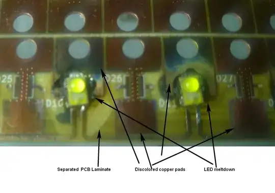

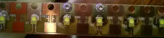

The PCB gets very hot without thermal management. After assembling the first test board I pumped 1 Amp through the LEDs. I do not know the temperature because the board got so hot so fast I didn't get a temperature reading before the board burned.
In a more sensible approach I was only able to measure up to 350mA before the temperature exceed the LED's maximum temperature.
* PAR = photosynthetic active radiation
The results so far tonight are looking very well with a new heatsink, designed with off the shelf commodity parts, where the total parts cost is $3.50 per foot.
When compared with no thermal management @ 350mA = 125°C, I think I may be on to something without thermal junction modeling.
