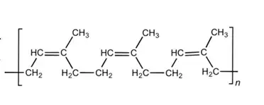

Let's assume that the rubber band is made out of natural rubber, which is a polymer of isoprene with some impurities in it. We'll ignore the impurities. The isoprene polymer, or polyisoprene, looks like this:

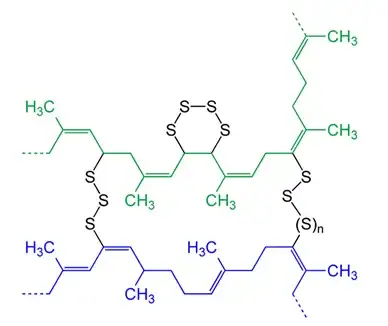

These long chains (n is easily > 10^4) can slip and slide across one another, and without any stability make for a really crappy material for holding things together (a chewed piece of gum molded into the shape of a band would have better elastic and stability properties). To add stability and elasticity to natural rubber, the polymers are crosslinked through vulcanization. Sulfur is added and makes bridges between neighboring polymers, allowing them to move but not get too far away. The crosslinked polymers look something like this, although note that the actual material wouldn't have as high of a sulfur density as depicted in this figure

Let's walk through your thought experiment. When the rubber band is stretched to the point of breaking, chemical bonds are broken. Looking at the cross-linked image above, the options are S-S bonds, S-C bonds and C-C or C=C bonds. Looking at the bond dissociation enthalpies we see that the S-S and S-C bonds are the weakest of the set; so in all likely hood, the bonds that are being broken are the bonds added through the vulcanization/cross-linking process.
In an oversimplified picture, we can express rubber band breaking like this:
$$formed\ band \rightleftharpoons broken\ band \\ S-C \rightleftharpoons S\cdot +\ C\cdot$$
I use double arrows here because in your thought experiment, we are assuming that the band breaking is a reversible processes. Given that bond breaking requires energy, it stands to reason that your conjecture has some merit; namely, bond formation is energetically feasible and given enough time should occur, resulting in a reformed band.
