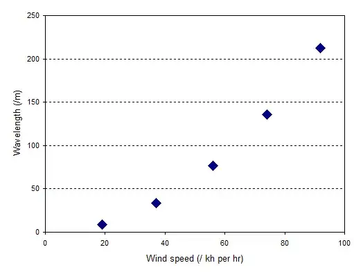

In the open sea waves are normally produced by the wind. When the wind hits the sea surface it creates essentially random patterns of pressure variation and these lift some parts of the surface up and press others down. Over time this creates waves. The important variable is the wind speed. There isn't a precise windspeed - wavelength relationship because the random nature of wave generation means you get a spread of wavelengths. However it's generally true that low wind speeds produce short waves and high wind speeds produce long waves.
I did a quick graph of the average wavelength against speed from the data in the Wikipedia article and I get:
Waves
The data doesn't include low speeds, but the trend is obvious.
I don't think there's a simple explanation for exactly why the wavelength depends on wind speed. According to the Wikipedia article the pressure variations created by the wind create small waves, but the wind then interacts with these waves and increases their wavelength. This is known as the Miles mechanism, and if you're sufficiently interested there is a paper about it here. However you'll need to pay to see more than the first two pages.
