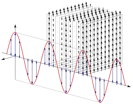

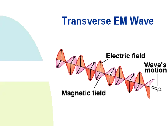

Take this typical picture of an EM wave.
It is so very tempting, yet incorrect, to think that the E and B field are only defined (non-zero) on that axis. No. Here's a better picture that only shows one of the two fields.
It's called a plane wave because the E and B fields have the same value everywhere on some plane. So if you imagine this wave incident on some cube, the dot product $\vec{E}\cdot d\vec{S}$ has a value at more than just one point.
