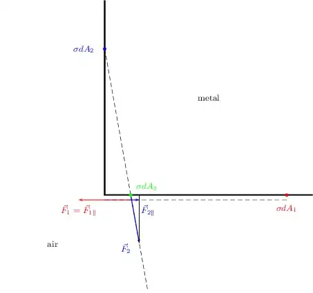

Consider a perpendicular edge of a cylindrical configuration as shown in the following picture.
Assume that the surface charge distribution would be uniform (constant charge per area).
There we have small surface charge elements $\sigma dA_1$ and $\sigma dA_2$ with $dA_1=dA_2$ generating a force on a small surface charge element $\sigma dA_3$ very close to the edge.
Thereby, $\sigma dA_1$ and $\sigma dA_2$ are just samples of the field generating surface charge elements over which we have to integrate. Nevertheless, we can discuss the main effect exemplary with their help. Both $\sigma dA_1$ and $\sigma dA_2$ have the same distance from $\sigma dA_3$ so that the absolute value of their field strength at the position of $\sigma dA_3$ is the same.
The tangent component $\vec F_{2\parallel}$ of the force $\vec F_2$ caused by $\sigma dA_2$ on $\sigma dA_3$ is small since $\vec F_2$ is directed almost normal to the surface.
On the other side the force $\vec F_1$ caused by $\sigma dA_1$ on $\sigma dA_3$ directly has tangent direction ($\vec F_1 = \vec F_{1\parallel}$).
Therefore, the sum of tangent forces $\vec F_{1\parallel}+\vec F_{2\parallel}$ on $\sigma dA_3$ will point towards the edge. In principle his holds also for the other charge elements contributing to the electrical field at the location of $\sigma dA_3$. Consequently, the surface charge $\sigma dA_3$ will move towards the edge until there is so much charge in the edge that for all surface charge elements the tangent component of the field strength is zero. ("The edge repells further charge.")
Eventually, at edges the surface charge density becomes infinite. Instead of a finite surface density you have a finite line charge density in the edge.
The effect at curved surfaces is similar but not so drastic.
