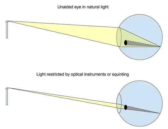

The essence of the difference that makes cataracts visible is illustrated in the diagram below.
In natural light images images can form directly behind a cataract from rays travelling around the obstruction. Optical instruments and also squinting, as Lenny mentions in the comments, restrict the rage of light paths available, creating shadows behind the cataract.
When looking with the unaided eye, light from a single point object reaches all parts of the lens and is focused back onto a single point on the retina. Light from all points on the lens reaches all point on the retina. Point defects on the lens affect the quality of the entire image rather than specific parts of it. Occlusions on or near the lens are equivalent to using a smaller lens. They predominantly make the image on the retina dimmer and fuzzier.
When optical instruments are used they do most of the focusing. The light reaching your lenses is already prefocused. The light going to a single point of your retina then only goes through a small part of the lens. Point defects on the lens only affect small parts of the image and occlusions on the lens actually block corresponding parts of the image.
