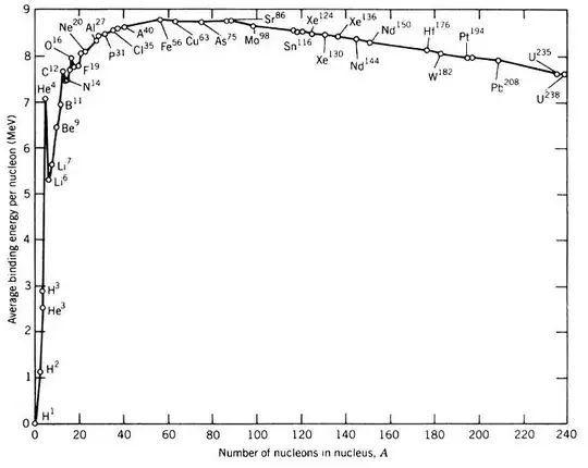

This is a graph of Binding Energy per nucleon for the various nuclei.
The fission of heavier nuclei would lead to daughters with higher binding energy than the parent (graph slopes downward towards the high mass end). Daughters will be stable, hence energetics favors fission for heavy nuclei.
In Response to comment:
This answer address fissionable nuclei, i.e elements heavier than iron. It has received justified criticism that this actually does not explain why certain nuclei are "fissile" (i.e nuclei that undergo fission when struck by slow thermal neutrons). After reading the question, I realize that the OPs concern was really with fissile materials. So I apologize for the initial answer which concentrated on fissionable nuclei.
The answer, btw, is still energetics. Wikipedia is a good starting point to get an explanation.
