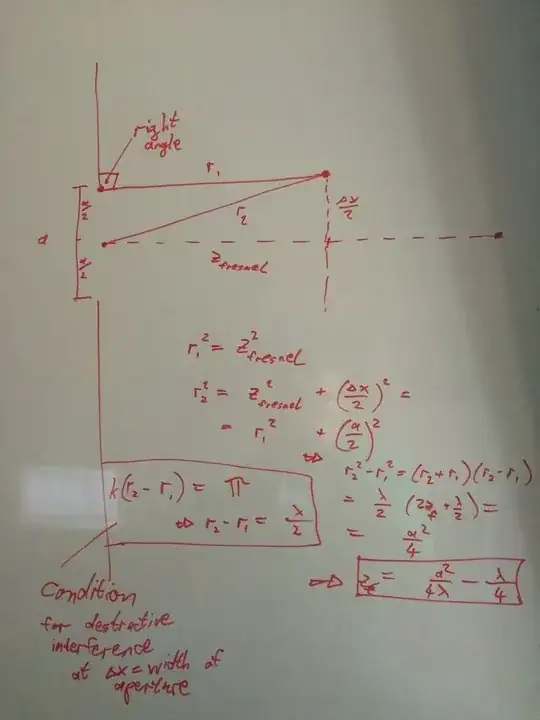

This is really just a geometry problem since we can not use Fraunhofer approximation in general. The solution depends on what you mean by "width" of the central maximum. If you take it to be the distance between the two adjacent minima (full width) then the solution is:
$$z_{\text{Fresnel}} = \frac{a^2}{4 \lambda} - \frac{\lambda}{4}$$

Here is my working. The crucial step is that at the minimum the interference is fully destructive, so for every point in the aperture exists another point in the aperture that is $\pi$ out of phase. Hence the phase difference at the minimum between edge of the aperture and the centre of the aperture is $\pi$ (see picture). The rest is then just doing the geometry.
EDIT in response to comments
I will try to give an explanation of how this fits with the question.
The distance at which this width equals the size of the aperture is called the Fresnel distance.
I calculated this distance above, fixing the ambiguous "width" to be the full width, as I explained (as opposed to full width half maximum). My derivation does not make any approximation other than scalar diffraction theory.
