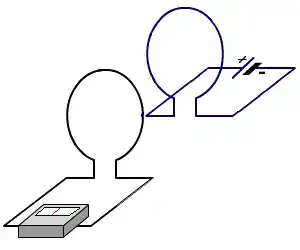

Consider two loops as shown:
image 2
(source: talkingelectronics.com)
There are two loops, blue and black. When the black loop is not present, the current in the blue loop is $i_1$. This current is constant and there is no self-induction; the battery has zero voltage since the loop is perfectly conducting. For the time being, consider this battery as a short circuit.
What happens when the black loop is placed in the vicinity of the blue loop? As the blue loop is moved to approach the black loop, the magnetic flux through both the blue and black loops change with time. This causes an induced EMF to appear in both loops. Both loops are ideal conductors, so we do not need any $E$ inside their wires to cause a current.
Suppose the initial current flowing through the black loop was $i_2$. Both $i_1$ and $i_2$ will change when the loops approach each other, but how?

To analyze this, consider again the previous loop$1$ and loop$2$, replacing the DC battery with an AC voltage source. The distance $x$ between the loops is not changed. Both loops are perfectly conducting and have comparable self-inductances and equal mutual-inductances. Since both the loops are ideal conductors, $E$ inside the wires of both will be $0$.
$$-\dfrac{d(\phi_{11}+\phi_{21})}{dt}+V_0 \sin(\omega t) =0 \implies V_0\sin(\omega t)=L_1\dfrac{di_1}{dt}+M\dfrac{di_2}{dt} \tag{1}$$
Also:
$$\dfrac{\phi_{22}+\phi_{12}}{dt}=0 \implies L_2i_2=-Mi_1+k \implies i_2=-M/L_2i_1+k$$
Using this value of $i_2$ in eq 1 we get
$$V_0\sin(\omega t)=(L_1-\dfrac{M^2}{L_2})\dfrac{di_1}{dt}$$
Let ${L_1-\dfrac{M^2}{L_2}}=\alpha$. Then we get an expression for $i_1$ as:
$$i_1=-\dfrac{V_0}{\omega \alpha}cos(\omega t)$$
We see $i_1$ varies with time and hence $i_2$ also so both the loops undergo self-induction and mutual-induction. This was a very conditioned analysis. Resistance was ignored but the thing is even including the resistance both self-inductance and mutual-inductance will occur.
