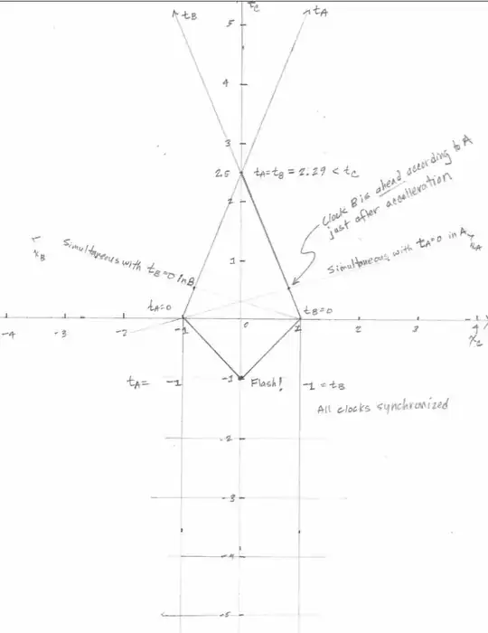

First and foremost, draw the spacetime diagram.
In the reference frame of the flash bulb, the other two clocks are always synchronized since those clocks have, at all times, the same speed as each other.
If you trace the wordline of the two accelerated clocks (in the frame of the flash-bulb), you'll find they are congruent and so, the proper time along the worldlines is the same.
Also (and again, this is plain to see on a spacetime diagram), while it is true that each moving clock observes the other to be running slow, there is also a time offset that is just such that the two clocks will read the same when they meet at the center.
This is easiest to see in the case that the acceleration to $0.4 c$ is instantaneous.
Before the acceleration, the clocks are in the same reference frame and are synchronized.
The moment after the acceleration, the clocks are in different reference frames and each clock observes the other to be ahead in time, i.e., to read a later time.
Thus, even though each clock observes the other to run slowly, there will be a time when each clock observes the other to read the same time as it reads and, not coincidentally, that moment will occur precisely when the clocks meet at the flash bulb.

Actually, no. When the two moving clocks meet, they both read the same time but both are behind the flash bulb's clock, i.e., the moving clocks show less elapsed time than the flash bulb's clock.
Added: the spacetime diagramenter image description here

In the spacetime diagram above, I drew the x axis for the flash bulb reference frames as well as the two clocks the moment after the acceleration. Recall that, all events along the x axis have time coordinate zero in their respective reference frames.
Thus, it is easy to see that, in A's reference frame (coordinate system), clock B reads a positive value simultaneous with clock A reading $0$.
