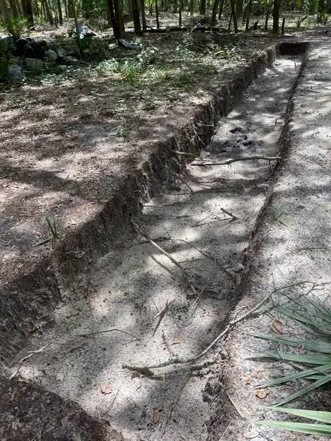

I have dug out a 3ftx3ftx44ft (d/w/h) (0.9mx0.9mx13m) area for raising tilapia, and I will be adding a layer of 6mm plastic to hold the water. I want to know whether I will need to buy a heater for this and if a cover at night would help keep the fish warm. I am worried about this especially because this winter is supposed to be really bad, so I want to invest in a heater now if it will be needed. Tilapia need to be in temperatures 55°F (12°C) or higher, so that is what I am aiming for at the minimum.
Fish hole
I assume I will need a heater, but I would like to hear from others before I buy one. Thanks in advance!

It is less of a pond and more of a rectangular hole in the ground. I am using it as a temporary tank until I finish my full pond
It is going to be much less stress and a lot more economical to finish first your actual pond, and use it for some time (does it need cycling, like aquariums? I do not know). And when things are finished, "invite" the fish to the pond. Do not start with buying the fish, and then continue by wondering what to do with them. Just a friendly idea.
1 meter below ground surface is definitely NOT underground. Just barely in the ground. You did not mention where in the world you want to grow this business, but be aware that in some areas, the water can get a layer of several cm (or more) of ice on top - if the tank is left open.
I will continue the answer with regard to temperature control, not about the fish. You will adjust the parameters according to your needs.
Your problem depends not only on what the fish need, but also on the tempratureS of the environment. Please notice the plural. Your "tank" touches the ground as well as the air (at least, in the picture you provided). You can have a cold ground and hot air during a hot spring day, and you can have warm ground and cold air during a weather anomaly in the summer.
So in order to maintain the temperature, you need insulation, before applying heating. The easiest insulation against the ground in polystyrene. There is a good variety of materials end technologies to choose from. please remember to cover both the bottom and the walls. You can create the walls above the ground (see below) at this step too - if you plan carefully.
The insulation against air requires a roof and walls - and these will also prevent dirt and garbage to fill your tank. During warm weather, the walls should remain open for fresh air. During the cold weather, close everything.
The heater on the bottom of the tank should be controlled by one or more sensors, to keep the temperature in the desired range, and the cost of the heating low. be careful that some heater can get very hot themselves, and therefore hurt the fish - I o not know what kind of technology you intend to use.
