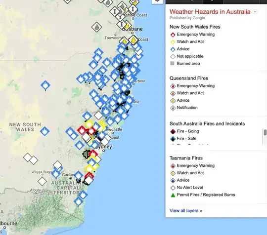

enter image description here Image courtesy of http://google.org/crisismap/australia
