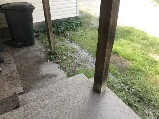

These are the stairs, for clarification:
stairs

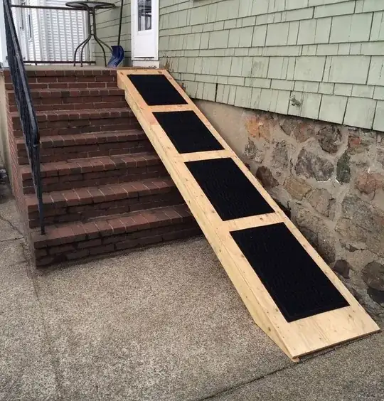

Build a ramp. After looking at your picture, I think it would be best to build it facing the side (right side of the picture) rather than lying over the steps. It could probably be a very simple design of a long board with legs on one side. Maybe you can even find a reasonably priced portable wheelchair ramp.
As shown in this picture, the ramp doesn't have to be as steep as the stairs themselves. example of dog ramp
There are a few things you should have in mind:
  • If possible, the top of the ramp should be at the same height as the top stair. That way you don't build another stair and possibility to stumble.
  • There must be no gap between the staircase and the ramp. A dogs paw is small and can be caught in small gaps.
  • The ramp has to be topped with a material that provides grip. Dogs slide easily on raw wood.
  • Considering the age of your dog, the ramp should be sturdy enough to not swing when the dog walks over it.
  • Again, considering the age of your dog, I would make the ramp at least 3 times as wide as your dog is. That eliminates the risk of falling should she stagger.

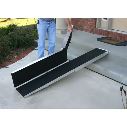

Again, a portable wheelchair ramp has all these properties. enter image description here
