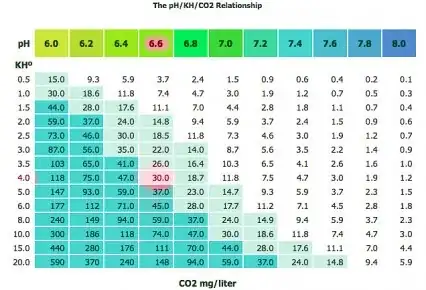

If your KH is 0 that means your pH can be very easily influenced by any factors that would affect your pH. In reference directly to CO2 check out this picture from practical fish keeping:
CO<sub>2</sub> Vs KH Vs pH
You'll see that the mg of CO2 per litre that you need for the pH to fall to 6 at a KH of 0.5 is only 15mg compared to the 87mg you might need for the same pH at a KH of 3.0.

However, if anyone wanted this mysterious riddle solved (I certainly did), the missing numbers for KH = 0 are around 0.1 mg/L for pH 6, decreasing below the precision limit of the table in Henders's answer until exactly 0 mg/L for pH 7, and N/A for above pH of 7:
pH Dissolved CO2 in ppm
6.0 0.1033
6.2 0.04112
6.4 0.01636
6.6 0.006516
6.8 0.002594
7.0 0
>7.0 N/A
