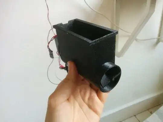

The 'machine' I made is an auger with a container on top for the kibble. A servo motor on the back turns the auger so kibble comes out. On the back is an ESP8266 board (basically a tiny computer with Wi-Fi) that connects to my home Wi-Fi so I can tell it to move and for how long. This is done automatically at set times, but I can also use my phone to trigger it. On the top you can see a wider part, which slides into a holder that is attached to the bottom of my shelf. The parts are 3D printed. It's a prototype so it still has some exposed wires in the back. This one is printed using PLA but I'm going to make another one out of a verified food-safe material.
Update 3: I didn't use this system for long. One reason was that my cat managed to get to the prototype and destroy it. But the main reason was that my cat was on edge all the time, completely focus on the sound of the servo and the kibble hitting the floor. It didn't seem healthy so we're back to feeding him ourselves again for now.
