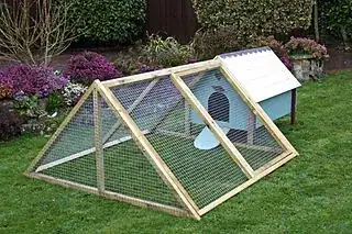

Chicken wire should work to keep a cat in, as it works to keep cats out of the chicken coop. The structure may not need be anchored to the house, the chicken run in this image is designed to be moved, the house and run just touch.
Cats can jump several feet, and they can climb, your run will need a roof, it can be solid or wire. Googling for 'outdoor cat run' images shows several different options. Your budget and layout will ultimately decide how extravagant your run is, but if it is solidly built and stable it does not need to be physically attached to your house, just touching it.
Lastly as you are living in a rental, you may want to plan so it can easily be taken apart and moved. If you look closely at the high resolution pictures of the chicken run you can see the carriage bolts that hold the sides together. Comes apart easily for storage or long moves.
enter image description here Image sourced commons.wikimedia.org
