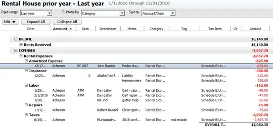

Here's an example (with some categories/accounts expanded - e.g. Labor - to show each transaction, and others collapsed - e.g. Rents Received - to show just totals.
Rental Property A

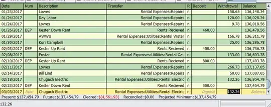

And a perhaps not-too-useful snapshot of my (say) Property A transactions: List of transactions

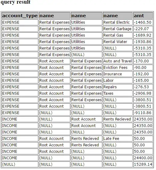

Here's a very basic MySQL query I put together that does what I want for income/expense report. Basically it reports the same info as the canned income/expense report, but limits it those income/expenses associated with a particular account (rental property, in my case). My main complaint is the output "report" is pretty ugly. And modifying for a different rental property requires changing the code (I could pass parameters etc).
Again, the main "issue" in my mind with GnuCash income/expense report is that there is no filter for which account (rental property) you want income/expenses for, unless you set up account tree so that each rental property has its own defined incomes and expenses (i.e. PropertyA:Expense:Utility:electric).
Hopefully someone will point me to a more elegant solution that uses the report generator built into GnuCash. THanks!
SELECT a2.account_type , a4.name, a3.name, a2.name, SUM(ROUND(IF(a2.account_type='EXPENSE',- s2.value_num,ABS(s2.value_num))/s2.value_denom,2)) AS amt FROM ( SELECT s1.tx_guid FROM gnucash.accounts AS a1 INNER JOIN gnucash.splits AS s1 ON s1.account_guid = a1.guid WHERE a1.name='Property A' ) AS X INNER JOIN gnucash.splits s2 ON x.tx_guid = s2.tx_guid INNER JOIN gnucash.accounts a2 ON a2.guid=s2.account_guid INNER JOIN gnucash.transactions t ON t.guid=s2.tx_guid LEFT JOIN gnucash.accounts a3 ON a3.guid = a2.parent_guid LEFT JOIN gnucash.accounts a4 ON a4.guid = a3.parent_guid WHERE a2.name <> 'Property A' # get all the accounts associated with tx in Property A account (but not the actual Property A Bank duplicate entries. AND t.post_date BETWEEN CAST('2016-01-01' AS DATE) AND CAST('2016-12-31' AS DATE) GROUP BY a2.account_type ,a4.name, a3.name, a2.name WITH ROLLUP ;
And here's the output. Hopefully someone has a better suggested approach!
