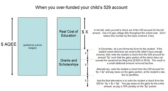

My prescription for managing a situation like this is not to pay directly out of the 529 account, but instead calculate your cost of education up-front and withdraw that money at the beginning of the school year. You can keep it in a separate account, but that's not necessary. The amount you withdraw should be equal to what the education costs, which may be estimated by taking the budget that the school publishes minus grants and scholarships. You should have all of those numbers before the first day of school. This is amount $X.
During the year, write all the checks out of your regular account. At the end of the school year, you should expect to have no money left in the account. I presume that the budget is exactly what you will spend. If not, you might need to make a few adjustments, but this answer will presume you spend exactly $X during the fall and the spring of the next year.
In order to get more out of the 529 without paying penalties, you are allowed to remove money without penalty, but having the gains taxed ($y + $z). You have the choice of having the 529 funds directed to the educational institution, the student, or yourself. If you direct the funds to the student, the gains portion would be taxed at the student's rate. Everyone's tax situation is different, and of course there is a linkage between the parent's taxes and student's taxes, but it may be efficient to have the 529 funds directed to the student. For instance, if the student doesn't have much income, they might not even be required to file income tax. If that's the case, they may be able to remove an amount, $y, from the 529 account and still not need to file. For instance, let's say the student has no unearned income, and the gains in the 529 account were 50%. The student could get a check for $2,000, $1,000 would be gains, but that low amount may mean the student was not required to file.
Or if it's more important to get more money out of the account, the student could remove the total amount of the grants plus scholarships ($y + $z). No penalty would be due, just the taxes on the gains. And at the student's tax rate (generally, but check your own situation).
Finally, if you really want the money out of the account, you could remove a check ($y + $z + $p). You'd pay tax on the gains of the sum, but penalty of 10% only on the $p portion.
