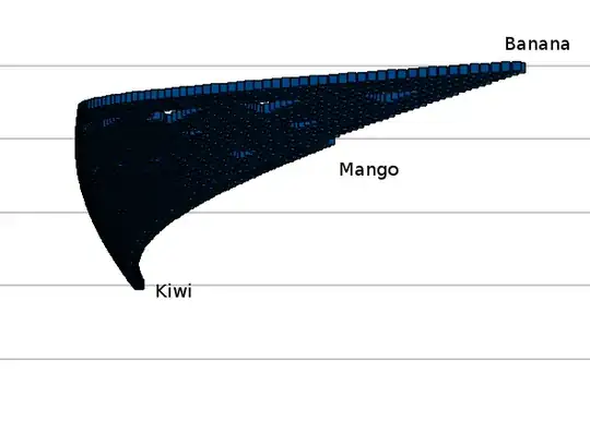

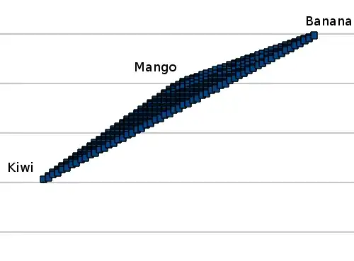

I have found this challenge almost impossible because I don't want to use too technical jargon, just nice pictures, gestures and analogies to everyday life. So I created this pathological example with monkey A and B. Monkey A is believes that reserving a variety of food such as bananas, mangos and kiwis will result in lower risk shown with first curved frontier.
x-axis would be technically standard deviation but you can suppose it is a risk to lose food from the average, y-axis the amount of editable food.
Can you find any argument, rather than some Python lines, to support one of the models? What kind of monkeys are A and B?
Monkey A`s view
Monkey B only believes in the Banana so gathers only them. It is a bit risky endeavour because they stale at the same speed and there are times when B hits almost 0 bananas but then again there are times when B hits a huge amount of bananas during harvest, much more than A can ever imagine. B won't even try the next best alternative, mocking mangos and such things in trees being too inferior. How to explain this kind of monkey what an efficient frontier is and when B's view is totally correct or incorrect?

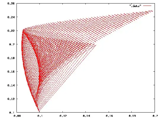

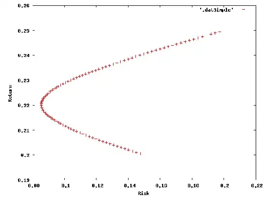

I would let them get their hands dirty, learn by practicing. Below you can find a simple program to generate your own efficient frontier, just 29 lines' python. Depending on the age, adult could help in the activity but I would not make it too lecturing. With child-parent relationship, I would make it a challenge, no easy money anymore -- let-your-money work-for-you -attitude, create the efficient portfolio!
If there are many children, I would do a competition over years' time-span or make many small competitions. Winner is the one whose portfolio is closest to some efficient portfolio such as lowest-variance-portfolio, I have the code to calculate things like that but it is trivial so build on the code below. Because the efficient frontier is a good way to let participants to investigate different returns and risk between assets classes like stocks, bonds and money, I would make the thing more serious. The winner could get his/her designed portfolio (to keep it fair in your budget, you could limit choices to index funds starting with 1EUR investment or to ask bottle-price-participation-fee, bring me a bottle and you are in. No money issue.).
Since they probably don't have much money, I would choose free software.
Have fun!
Step-by-step instructions for your own Efficient Frontier
  1. Copy and run the Python script with $ python simple.py > .datSimple
  2. Plot the data with $ gnuplot -e "set ylabel 'Return'; set xlabel 'Risk'; set terminal png; set output 'yourEffFrontier.png'; plot '.datSimple'" or any spreadsheet program.
  3. Your first "assets" could well be low-risk candies and some easy-to-stale products like bananas -- but beware, notice the PS.
