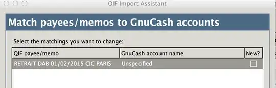

When importing that file, the match still not occurs :
What edit should I do on the QIF file so the import assigns existing Cash in Wallet account as Gnucash account name to the transaction ?

Everything is clear now that I found QIF specification.
I forgot the leading L that indicates it is a category field.
!Type:Bank
D05/02/2015
T-40.00
PRETRAIT DAB 01/02/2015 CIC PARIS
LCash in Wallet
does work.
