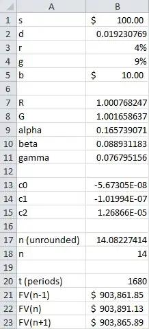

Using Newton's method to find roots of f(n) above, we get n = 14.004.
Using the closed-form approximate solution, we get n = 14.082.
Checking this against the FV with t = 1680 (evenly divisible by each n + 1 tested):
  • When n = 13, FV = $903,861.85
  • When n = 14, FV = $903,891.13
  • When n = 15, FV = $903,865.89
Therefore, you should wait for n = 14 periods, keeping that money in the bank, investing it together with the money in the next period (so you will make an investment every 14 + 1 = 15 weeks.)

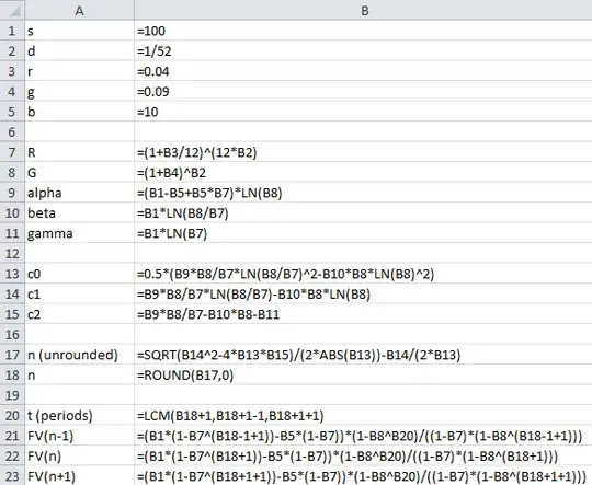

Spreadsheet:
Here's one way to implement the above solution with a spreadsheet. StackExchange doesn't allow tables in their syntax at this time, so I'll show a screenshot of the formulae and columns you can copy and paste:
Formulae:
Spreadsheet formulae
Copy and paste column A:
s
d
r
g
b
R
G
alpha
beta
gamma
c0
c1
c2
n (unrounded)
n
t (periods)
FV(n-1)
FV(n)
FV(n+1)
Copy and paste column B:
=100
=1/52
=0.04
=0.09
=10
=(1+B3/12)^(12*B2)
=(1+B4)^B2
=(B1-B5+B5*B7)*LN(B8)
=B1*LN(B8/B7)
=B1*LN(B7)
=0.5*(B9*B8/B7*LN(B8/B7)^2-B10*B8*LN(B8)^2)
=B9*B8/B7*LN(B8/B7)-B10*B8*LN(B8)
=B9*B8/B7-B10*B8-B11
=SQRT(B14^2-4*B13*B15)/(2*ABS(B13))-B14/(2*B13)
=ROUND(B17,0)
=LCM(B18+1,B18+1-1,B18+1+1)
=(B1*(1-B7^(B18-1+1))-B5*(1-B7))*(1-B8^B20)/((1-B7)*(1-B8^(B18-1+1)))
=(B1*(1-B7^(B18+1))-B5*(1-B7))*(1-B8^B20)/((1-B7)*(1-B8^(B18+1)))
=(B1*(1-B7^(B18+1+1))-B5*(1-B7))*(1-B8^B20)/((1-B7)*(1-B8^(B18+1+1)))
Results:
Spreadsheet results
Remember, n is the number of periods to accumulate money in the bank. So you will want to invest every n+1 weeks; in this case, every 15 weeks.

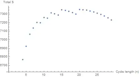

The problem is not difficult to calculate but it is difficult to produce a formula for. For example, if you are putting aside $100 per month, and investing every n saved amounts.
amount put aside every month                s = 100
effective bank rate of 5% to monthly rate   r = (1 + 0.05)^(1/12) - 1
effective stock rate of 10% to monthly      g = (1 + 0.10)^(1/12) - 1
brokerage fee per trade                     b = 65
saved value after n months      a = x[n] = (s ((1 + r)^(n + 1) - 1))/r
invested value after n months       z[n] = (a - b) (1 + g)^n

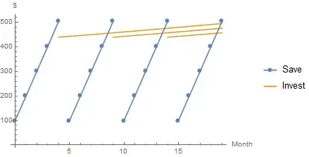

With a cycle length n = 5 amounts before investing, a schematic looks like so:-
Each investment amount at five month intervals is $439.09, shown by example calculations.
100 (1 + r)^4 + 100 (1 + r)^3 + 100 (1 + r)^2 + 100 (1 + r) + 100 - 65 = 439.09
n = 5
a = x[n - 1] = 504.09
z[0] = 439.09
The schematic shows the investments extending only over 19 months.
The total for investments over 60 months, including the $100 put aside in month 60, is $6769.86, i.e.
For j = 60, 55, 50, 45, 40, 35, 30, 25, 20, 15, 10, 5, 0
If[j < n, x[j], z[j - n + 1]]
final values = 685.05, 658.37, 632.74, 608.11, 584.43, 561.68,
               539.81, 518.79, 498.59, 479.18, 460.52, 442.59, 100
Total = 6769.86

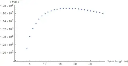

Looking over a range of cycle lengths, all to 60 months, the totals are erratic.
Note, j is taken from the maximum, so for investments over, say, 62 months
j = 62, 57, 52, 47, 42, 37, 32, 27, 22, 17, 12, 7, 2
Extending for 600 months smooths out the curve giving a clear optimum of n = 18. Same n for 6000 months; the curve is now static (although the totals change). Recalculation can be made for different interest rates, periodic amount and brokerage fee.
As mentioned though, producing a formula for the optimal n is not so easy.

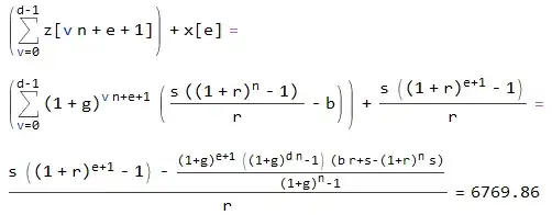

An expression for the total at each n can be obtained, e.g. with
max = 60
n   = 5
d   = Quotient[max, n] = 12   (the integer quotient of max and n)
e   = Mod[max, n] = 0
(s ((1 + r)^(e + 1) - 1) -
   ((1 + g)^(e + 1) ((1 + g)^(d n) - 1) (b r + s - (1 + r)^n s))/
    ((1 + g)^n - 1))/r = 6769.86

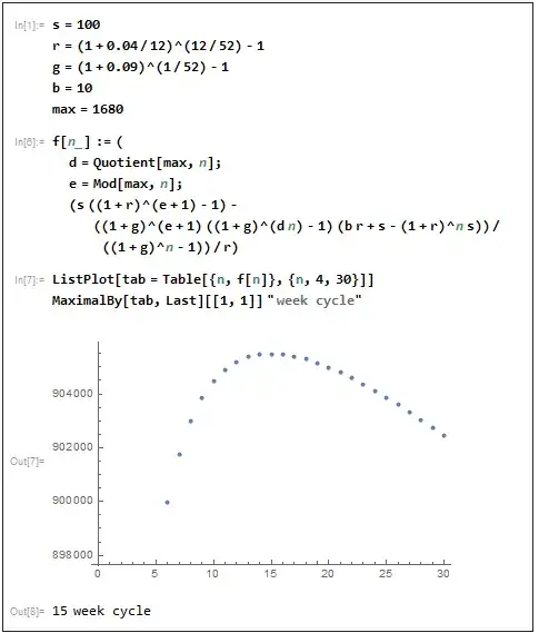

Applying this to the OP's demo question
For example, I might put aside $100 every week to invest into a stock with an expected growth of 9% p.a., but brokerage fees are $10/trade. For how many weeks should I accumulate the $100 before investing, if I can put it in my high-interest bank account at 4% p.a. until then?
Taking the bank rate as nominal compounded monthly and the stock rate as effective.
The amount invested upon accumulation of each 15 amounts is
((1 + r)^14 + (1 + r)^13 + (1 + r)^12 +
 (1 + r)^11 + (1 + r)^10 + (1 + r)^9 +
 (1 + r)^8  + (1 + r)^7  + (1 + r)^6 +
 (1 + r)^5  + (1 + r)^4  + (1 + r)^3 +
 (1 + r)^2  + (1 + r) + 1) s - b = 1498.09
