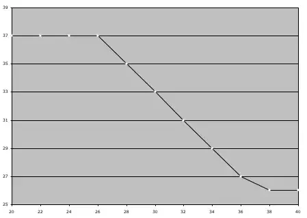

You own the stock at $29.42
At $40, the stocks is called at $26. You can't add the call premium, as it's already accounted for. The trade is biased towards being bearish on the stock. (I edited and added the graph the evening I answered)
Not the pretiest graph, but you get the idea. With that $29.42 cost, you are in the money till about $30, then go negative until the most you lose is $3.42.

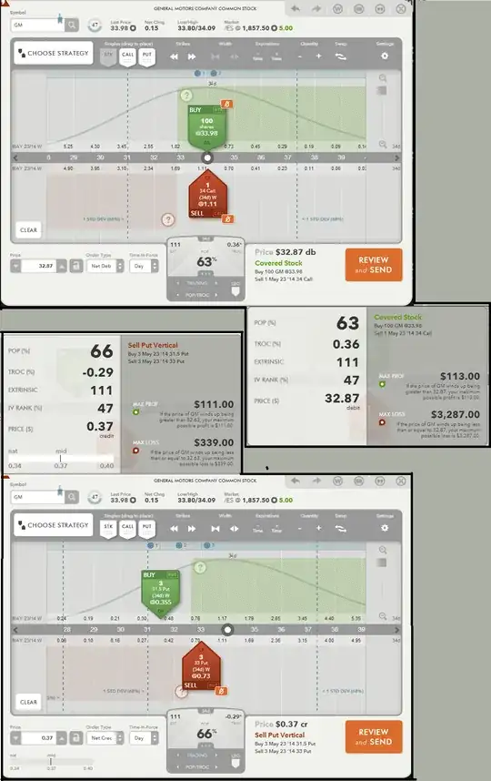

FYI: GM has an earnings announcement on April 24th.
I think you were trying to create a safe trade by profiting if GM's price fell within a probable range. The chart of the Iron Condor captures just about a standard deviation of movement. So as long as GM is between 31.28 - 37.22 in 34 days you keep the max profit of $110. Note this trade is a net credit, when placing it you get $110 less fees.
Iron Condor 1 std
Also by selling the deep in the money call I take it you were trying to make the most of your capital.
The chart below shows a standard covered call compared to short put vertical. Note the short put vertical simulates the covered call position and it is a net credit trade as well. When you drop the order you get $111 less fees.
CC vs Short Put Vertical
