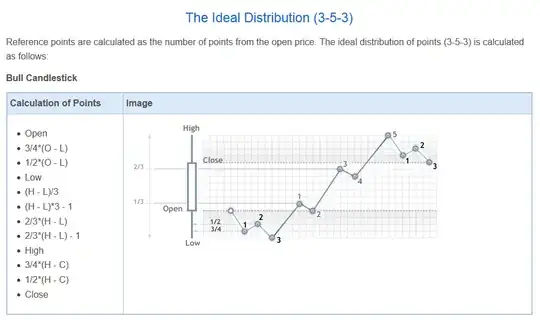

This is a good old question. However, in recent versions of Metatrader-5, they provide THIS description for calculating candle sticks, based on intra-timeframe ticks. Here is one of the diagrams they use to describe it. It should be noted that all "points" are Bid points.
Additional info can be found here.
