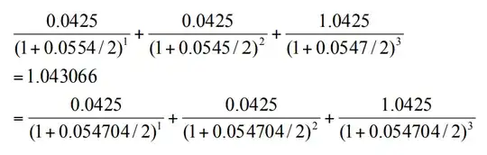

Unlike claimed in another answer, YTM and yield curves are not directly related, as in a single YTM number does not imply that the yield curve is flat (or has any particular shape). A bond’s yield is a kind of average of the yield curve rates that correspond to its cash flows. The first equation in the screenshot from NYU.edu below shows a 1.5 year, 8.5% coupon bond which is discounted with zero rates (first part). The second one is with YTM. Using the rates 5.54%, 5.45% and 5.47% results in a bond value of 1.043066. This corresponds to a YTM of 5.4704%.
