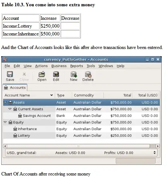

Using GNUCash, help, putting it all together, I'm accounting for a lottery income transaction.
GNUCash_example
I was able to get the example shown with 2 transactions.
 1. Dr. Savings        750,000
    Cr. Income:Lottery          750,000
 2. Dr. Income:Lottery 750,000
    Cr. Equity:Lottery          750,000
Result: Account Balances
     1. Savings 750,000
     2. Income        0
     3. Equity  750,000
Questions:
  1. As a general accounting practice, by what process does Income become Equity?
  2. Are the above two transactions the way to properly, according to accounting rules, record this event?

GnuCash uses the extended accounting equation, which is
 Assets - Liabilities = Equity + Income - Expenses
Confusingly, the entire right hand side (Equity + Income - Expenses) is also known as Equity if you use the standard accounting equation (as THEAO has pointed out). The equity you're trying to increase is the entire right hand side, and in GnuCash this is usually done by increasing your income. GnuCash will keep track of your overall equity on its own.
Equity accounts in GnuCash aren't meant to have your overall equity as a balance. To quote Derek Atkins from the gnucash-users mailing list:
You are confusing "Equity Accounts" from "Instantaneous Equity".. The I.E. includes Income and Expense values, which are not rolled up into your Equity Accounts. To compute your Instantaneous Equity you need to run a Balance Sheet.
Your Equity accounts will always show your equity at a single point in time. Generally it's the Opening Balances, but you can roll up your Income and Expense accounts into an Equity account by "closing the books".
Closing the Books
(...) “closing the books,”--an accounting process that resets the balances of the income and expense accounts. In this process, income account balances are transferred into an income equity account, while expense account balances are transferred into an expense equity account. (...)
Closing Date (...)
Income Total: Specify the account into which the total balance of all income accounts will be transferred. (...)
Expense Total: Specify the account into which the total balance of all expense accounts will be transferred. (...)
How It Works (...) GnuCash just uses [ordinary] transactions to close the books (...)
Necessity (...) Note that closing the books in GnuCash is unnecessary. You do not need to zero out your income and expense accounts at the end of each financial period. GnuCash’s built-in reports automatically handle concepts like retained earnings between two different financial periods.
In fact, closing the books reduces the usefulness of the standard reports (...)

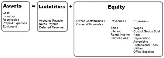

Towards your question #1 The basics of double-entry accounting run off of the equation that (Assets) - (Liabilities) = (Owner's Equity).
In terms of double entry bookkeeping, you always need 1 "event"'s set of transactions to balance the left (A - L) and right (OE) sides of the equation. Here are some examples to show what I mean:
Ex 1: Company starts with $100 in cash from last period. This would show up on the balance sheets as A: $100 Cash L: $0 = OE: $100.
Company buys $50 worth of ice cream. This would record as A: -$50 Cash --> A: +$50 Inventory
Company sells all the ice cream for $75. This would record as A: +$75 Cash --> A: -$50 Inventory --> OE: $25 (Profit).

THEAO
  • 3,391
  • 18
  • 31
Income doesn't "become" Equity as such; Income ( = Revenue) is Equity:
That is to say, the Income and Expense Accounts are sub-accounts to the Equity Balance Sheet account(s).
