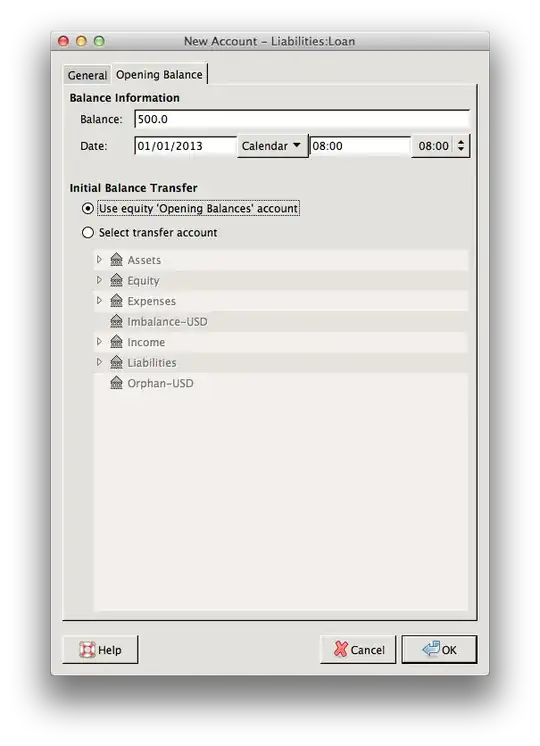

Typically in GnuCash, account balances that exist at the beginning of the time you're keeping records for are balanced by entries in an Equity account “Equity:Opening Balances”, which is part of the default set of accounts created for you. This account is really just a placeholder so that everything balances, and that's perfectly normal.
So, just enter “Equity:Opening Balances” as the “other entry” when entering the first, opening balance, transaction in your Liability account for the loan. If you have not already created the liability account, then just use the “Opening Balance” tab of the New Account window to enter the initial balance as you create the account.
(Screenshot of GnuCash)
(Disclaimer: I have no formal knowledge of accounting; I just use GnuCash and read the users' mailing list.)
