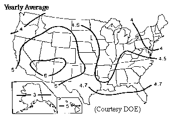

To answer the investment aspect takes a bit of math. First, solar insolation numbers:
This represents the average sun-hours per day for a given area. You can see the range from 4 to 6, or 1460 hrs to about 2190 hrs of sun per year depending on location. I believe electricity also has a range of cost, but 15 cents per KWH is a good average.
So, a 1KW panel will produce as much as $328 per year of electricity in a high sun-hrs area, but only $219 in a lower sun-hrs area.
