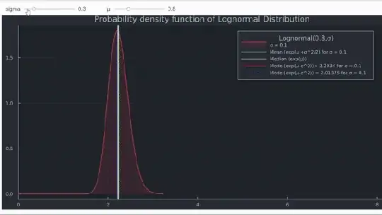

The answer by @Hart CO is intuitively correct but within a Black Scholes framework, this is actually quite a brain teaser as the probability of ITM options expiring ITM indeed decreases with increasing vol.
Intuitively, volatility of an underlying doesn't care about options. If you think about it, why would an OTM option benefit from vol if an ITM would not. The former still needs prices to increase, whereas the latter is already ITM. There is only one underlying (for any given option chain on some security). For calls, if we believe the higher strikes benefit, surely the lower strikes must benefit as well.
Mathematically, this is a lot more nuanced because the higher vol, the more the lognormal distribution tries to extend itself on both sides of the definition domain where it hits a boundary at zero, and probability accumulates. For this reason, the risk neutral probability of ending up in the money in a Black Scholes setting does indeed decrease all the time for ITM calls when IV increases.
For OTM calls on the other hand, increasing IV initially increases the probability, before it also starts to decrease. The explanation pins down to the so called volatility tax and convexity adjustment. Probably even more interesting, although the risk neutral probability of the call option expiring ITM becomes zero for very high vol, the price itself approaches its maximum possible value (the discounted forward / spot in case of no dividends).
Since mathjax isn't supported here, I recommend looking at this answer on quant stack exchange. It combines a mathematical explanation with animated GIFs and charts to explain this in detail. Just a quick teaser below:
