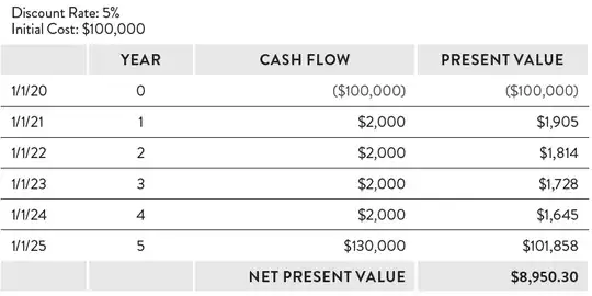

...in the investing and finance world, we’re often dealing with projects that are financed through debt. When financing a deal, the question often isn’t “Do the returns on this investment beat out the returns on an alternative investment?” Instead, the question is often “Are the returns on this investment enough to surpass our cost of debt?”
Let’s say that we have the opportunity to invest $100,000 in a deal that would return $2,000 per year for four years, and then $130,000 in Year 5.
Further, let’s say that we didn’t currently have the cash to make this investment, but we knew that we could take out a home equity line of credit (HELOC) on our personal residence to acquire the $100,000 to invest... The interest rate on the HELOC in this example would be 5 percent.
Does it make sense to borrow money against our personal residence at 5 percent interest for this investment? NPV can give us that answer:
Our NPV in this scenario is positive. In other words, we would make money—in today’s dollars—by borrowing $100,000 at 5 percent interest for five years to do this deal. Specifically, the return on this deal would surpass our hurdle (discount rate) of 5 percent interest on the loan we took out to fund the deal.

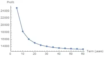

Plotting for various terms, arranging the shortest term is the most profitable because the payments are higher and the loan is paid-down quicker lessening the interest paid.

The present values of all cash flows are:
Loan: -100000
Yearly revenue: 2000 a_[4, 0.05] = 2000 (1 - 1.05^-4)/0.05 = 7091.90
Sale: 130000 (1.05)^-5 = 101858.40
Therefore, the net present value is 101858.40 + 7091.90 - 100000 = 8950.30 at the time of the issuance of the loan. Assumptions are that the interest rate on the loan is constant and reflects, irrespective of the schedule of payments, the effective annual rate of interest. Also, the revenue is paid at the end of each year, and the sale occurs at the end of five years.
There is no need to do any additional computations to account for the loan structure: the equation of value must balance for any fixed valuation point, and all cash flows are simply discounted or accrued to represent their present values at that time point.
I should also mention that this calculation does not depend on the term of the loan, as long as it is at least 5 years. This is because the proceeds from the resale of the property would be used to pay off the loan balance in full. Otherwise, additional unstated assumptions would come into play, such as the interest rate that you could receive by investing the proceeds of the resale.
