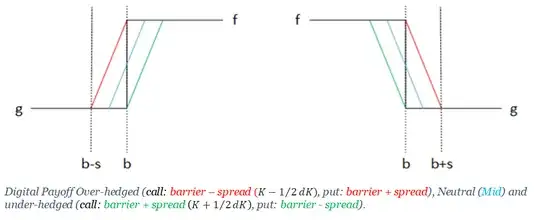

If the underlying expires (_) in a small region < _ < + where < /2 then a seller of the digital has to pay out more than the hedge nets. If on the other hand, you set the strikes as _− = -/2 and , then you make money regardless of where the underlying expires. This is called an over-hedge as illustrated in the figure below.
An over-hedge will cost more than the centred hedge on the barrier strike, because its payoff is strictly higher. That is a detail that is omitted in the figure above (the payoff diagrams would shift slightly, reflecting different costs for the premium).
Market makers frequently make the spread expiry and vol dependent. That is something you will typically not find at vendors like Bloomberg (their internal pricer, not what market makers show on FXGO) where spreads are simply kept constant for all digitals (like the 1% illustrated above).
