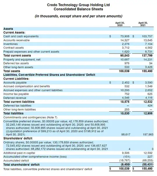

For some recently public companies, total assets minus total liabilities is a positive number, but shareholders' equity is negative. In some cases, this appears to be the result of a past sale of preferred shares. Credo (NASDAQ: CRDO) offers one such example:

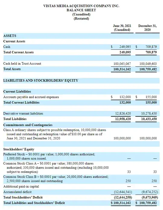

In other cases, the shareholders' equity appears to be negative as the result of a SPAC acquiring or merging with the company in return for common stock with a guaranteed redemption value (perhaps guaranteed for only a fixed length of time). Vistas' acquisition of Anghami (NASDAQ: ANGH) may be an example of this:
The negative shareholders' equity in these examples (and similar examples) seems like it could be a concern to investors. But should it be? If net income is also negative and will be so for a long time, are there ways that shareholders' equity can flip back into positive numbers without the company selling more stock?

In examples like those in the original post (CRDO and ANGH), the preferred stock, warrants, or other items in the "Commitments and Contingencies" section of the balance sheet may eventually be converted to common stock or expire. When this occurs, common shareholders' equity will increase by the corresponding amount, since these items no longer represent commitments with priority over common stock. In such cases, shareholders' equity may switch from negative to positive values without the company generating positive income or selling more stock.

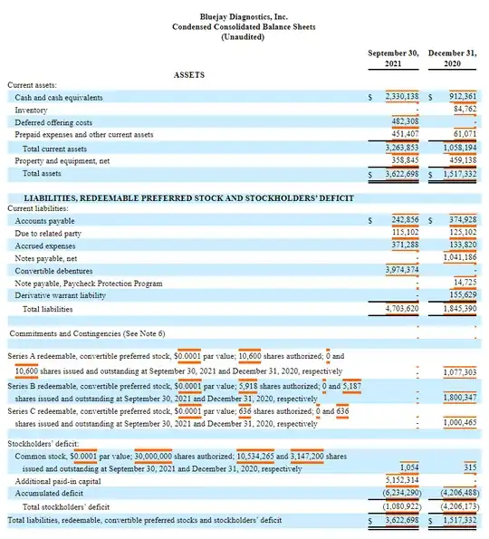

Let's consider a few examples. The balance sheet for Bluejay Diagnostics (NASDAQ: BJDX) shows a case in which convertible preferred stock was converted to common stock, and this appears to have led to an increase in shareholders' equity of a little over $3M:

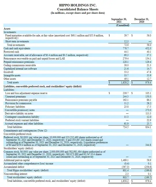

Similarly, the balance sheet for Hippo Holdings (NYSE: HIPO) appears to show an instance in which preferred shares were converted to common stock and this increased shareholders' equity by about $1.1B:
In the case of SPAC warrants, it may be that once the warrants can no longer be redeemed for common stock, the redemption agreement (at $10/share in the case of CRDO) no longer represent a commitment with priority above common stock, and therefore shareholders' equity may increase accordingly, again without the company issuing new shares or generating positive income.
