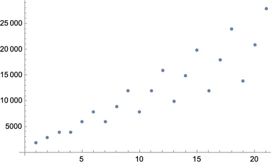

ListPlot[Array[f, 21]]

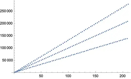

Plotting out to 210 months
ListPlot[Array[f, 210]]
