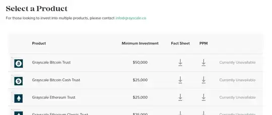

Separately, redemptions and private placements to the fund are closed.
From the Grayscale site
  • Grayscale Bitcoin Trust does not currently operate a redemption program and may halt creations from time to time. There can be no assurance that the value of the shares will approximate the value of the Bitcoin held by the Trust and the shares may trade at a substantial premium over or discount to the value of the Trust's Bitcoin. The Trust may, but will not be required to, seek regulatory approval to operate a redemption program.
And from the Private Placement section of the Grayscale Site:
So there are a few contributing factors that can explain why this spread isn't being arbed away. Leaving aside the 6-month lockup and living in the fantasy world of indifference to dollar fluctuations, the pool of people who could arb this away is extremely small, one. So you can't exploit this opportunity, if you think that's what this is.
