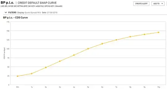

I'm looking at CDS curve for a company (see below). I understand the textbook meanings of these CDS spreads which is the premium paid on a notional value to insure against a credit event.
I want to know how 5-year CDS and 10-year CDS relate to each other? Are all these spreads annualised i.e. for 5-year CDS, you have to pay the spread (on notional) PER ANNUM? If yes, why would anyone pay 5 year CDS spread per annum (which is higher) rather than rolling a new contract for 1 year instead?
Also, what does coupon for a swap (100 for instance) imply?
Also to add, I believe it may be because of pricing certainty over the period of contract why someone may want to transact for a longer duration. But I need to confirm that this is the only reason
CDS curve for BP plc
Yes it is annualized, although payments are typically more frequent, so if the payments are quarterly you'd pay X/4 per quarter.
Because you are locking in a premium for 5 years. Companies don't go bankrupt overnight. They will more likely show weakening financials over several months, even year, before they default. These trends will result in a slow rise in the CDS spread curve well before the company defaults. If you just roll 1-year CDSs, you might end up paying much more for that protection then you would if you had locked in a 5-year CDS.
CDSs are insurance, so let's use life insurance as an analogy. Suppose you didn't buy 5-year term life insurance but every year renewed a 1-year term policy at current rates. You then get a diagnosis of some illness with an estimated 18 to 36 months to live. When it comes time to renew after that diagnosis, your 1-year term insurance premium will skyrocket; if you had instead bought a 5-year term policy, your insurance costs would remain the same despite the bad news.
It implies that for a 5-year CDS you'll pay 100 basis points (1%) annualized (i.e. if the premium is paid quarterly, it would be 0.25% per quarter) of the notional amount of protection in premium for the protection.
