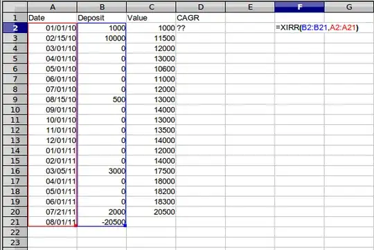

I should say that I'm not married to XIRR, I just want to calculate the return on a running basis in a column next to dates, deposits and balances. Here's a screenshot of a simplified spreadsheet in LibreOffice Calc (f/k/a OpenOffice.org Calc; I believe Google Apps is based on their code base):
spreadsheet screenshot
In F2 I've got the formula I'd use to calculate the return over the entire timespan. Note that I had to include the value at the end as a negative cashflow. This makes it so that (a) I can't easily keep adding rows to the bottom and (b) I can't get a return% value for each row in column D.
Is there a way to include that final cashflow in the formula? Some kind of ad hoc array that can include the value from column C?
I have another spreadsheet where I've duplicated columns A and B (including the final negative cashflow) for every year that I want a return value for. This approach is tedious and error prone.
In case it matters, there are only deposits, never withdrawals -- I'm using this for a retirement account, and I've got a ways to go before I take anything out...

Set your xirr formula to a very tall column, leaving lots of empty rows for future additions.
In column C, instead of hardcoding the value, use a formula that tests if it's the current bottom entry, like this:
=IF(ISBLANK(A7),-C6, C6)
If the next row has no date entered (yet), then this is the latest value, and make it negative.

I could not figure out a good way to make XIRR work since it does not support arrays. However, I think the following should work for you: Insert a column at D and call it "ratio" (to be used to calculate your answer in column E). Use the following equation for D3: =1+(C3-B3-C2)/C2 Drag that down to fill in the column. Set E3 to: =(PRODUCT(D$3:D3)-1)*365/(A3-A$2) Drag that down to fill in the column. Column E is now your annual rate of return.
