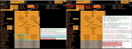

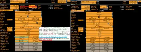

It is quick to check with excel or some coding language that this indeed can happen:
import numpy as np
from scipy.stats import norm
def BSM(S,K,r,d,t, sigma, cp_flag): d1 = ((np.log(S/K) + (r - d + 0.5 * sigma *2) t) / (sigma * np.sqrt (t))) d2 = d1 - sigma * np.sqrt(t) opt = cp_flagS norm.cdf(cp_flagd1) - cp_flag K * np.exp(-rt) norm.cdf(cp_flagd2) delta = cp_flagnp.exp(-dt)norm.cdf(cp_flag*d1) return opt, delta
Below is a screenshot from Bloomberg (ignore the underlying, I just manually entered the OPs data and the calculator is simply like a spreadsheet that takes inputs).
This structure has a negative (total) delta. I am convinced that the IV the OP stated was mixed up between the buy and sell position because otherwise it would not be negative. After all, it is the high IV that makes this possible. Also, vol smiles for such far OTM are always increasing. You can for example look at the last figure in this answer to see this.
The figure on the right shows you the option price change of a 1% increase in spot price as the approiximate value based on delta. You see that this is indeed negative.
