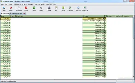

Upon successfully importing your transactions, you should be able to see your transactions in the Checking Account and Savings Account (plus additional accounts you have imported).
The Imbalance account (GBP in my case) will be negative of whatever you have imported. This is due to the double-entry accounting system that GnuCash uses.
Now, you will have to open your Savings Account.

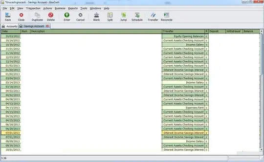

Note that except for a few transactions, most of them are going to Imbalance. These are marked out with the red rectangles.
What you have to do, now, is to click on them individually and sort them into the correct account. Unfortunately (I do not understand why they did this), you cannot move multiple transactions at once. See also this thread. Fortunately, you only have to do this once.
This is what your account should look like after it is complete.

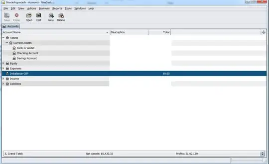

After this is done, you should not have to move any more accounts, since you can directly enter the transactions in the Transfer box. At this point, your Accounts tab should look like this:
Question solved!
