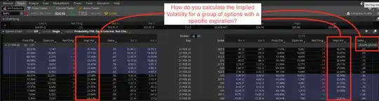

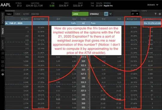

I attach a couple of pictures of the same option chain where I explain what I am trying to compute... (By the way... I have no idea why two different brokers platforms provide slightly different IVx values...).
Image 1 - Option chain on tastyworks IVx:
Image 2 - Option chain on thinkorswim IVx:

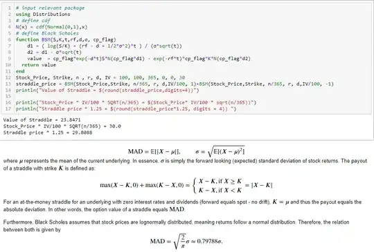

The screenshot below has some additional details, including some math that I will explain below. The reason I include the formulas as a screenshot is that money stack exchange unfortunately does not support Latex / mathjax.
  • method 1: The straddle costs $23.8471, suggesting a move of +/- $23.85
  • method 3: Stock_Price * IV/100 * SQRT(n/365), you get a neat solution in our case, which simply corresponds to IV, hence to a +/- $30 range. As you can see, your method 1 cannot be correct, if method 3 were correct.
  • method 2 (modified): However, using 1.25 * Straddle results in +/- $29.81 in our example which is almost identical to method 3.
Details
The price of straddle is not equal to the standard deviation (e.g. volatility) but to the mean absolute deviation (MAD) of the stock price. Since this StackExchange does not support mathjax, I included this in the screenshot above. The proof for the last statement can be found on math.stackexchange.com.

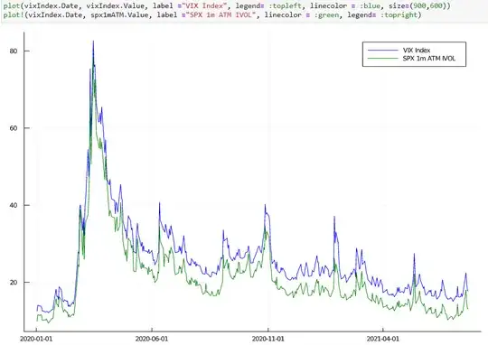

Insofar, using the VIX type value is not a bad idea. On the other hand, a generic 1m ATM vol is not very different from VIX (in value, not in how it is computed). Below is a comparison, where the 1m ATM vol comes from an in house vol surface.
