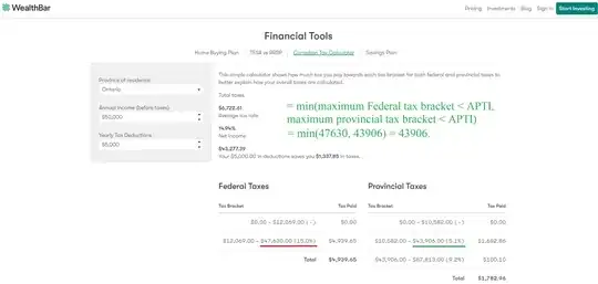

  1. is optimal RRSP deduction = min([RRSP contribution limit, 8% taxpayer’s pre-tax earned income for previous year, min(Maximum federal tax bracket < APTI, Provincial tax bracket < APTI))? I don't think I formulated correctly.
    I input my dad's facts into WealthBar -
  1. Thus my dad ought contribute to his RRSP 50K (annual income pre-tax) - 5K (yearly tax deductions) - 43906 = 1094. Correct?
Your formula above is correct in terms of maximum return on investment for RRSPs.
The "optimal" RRSP contribution really depends on your anticipated financial future and savings goals.
RRSP contributions are refundable tax credits, which means you get the entire amount of income tax paid on that dollar amount refunded. This is because RRSPs are taxed when the money is withdrawn, not when it is contributed, it is effectively delaying the income tax to when you are retired and have a low annual income, usually one or two marginal tax brackets below your current income.
Your dad's current income tax bracket is 29.65% (9.15% Provincial, 20.5% Federal) However it appears that he already has $5000 in tax credits from your post. This would bring his tax bracket down to 24.15% (9.15% Provincial, 15% Federal). He would get the largest return by contributing the maximum amount remaining in this 24.15% tax bracket, which you correctly calculated as $1094. If he contributes any more than this, he will only get a 20.05% tax return on those additional contributions.
